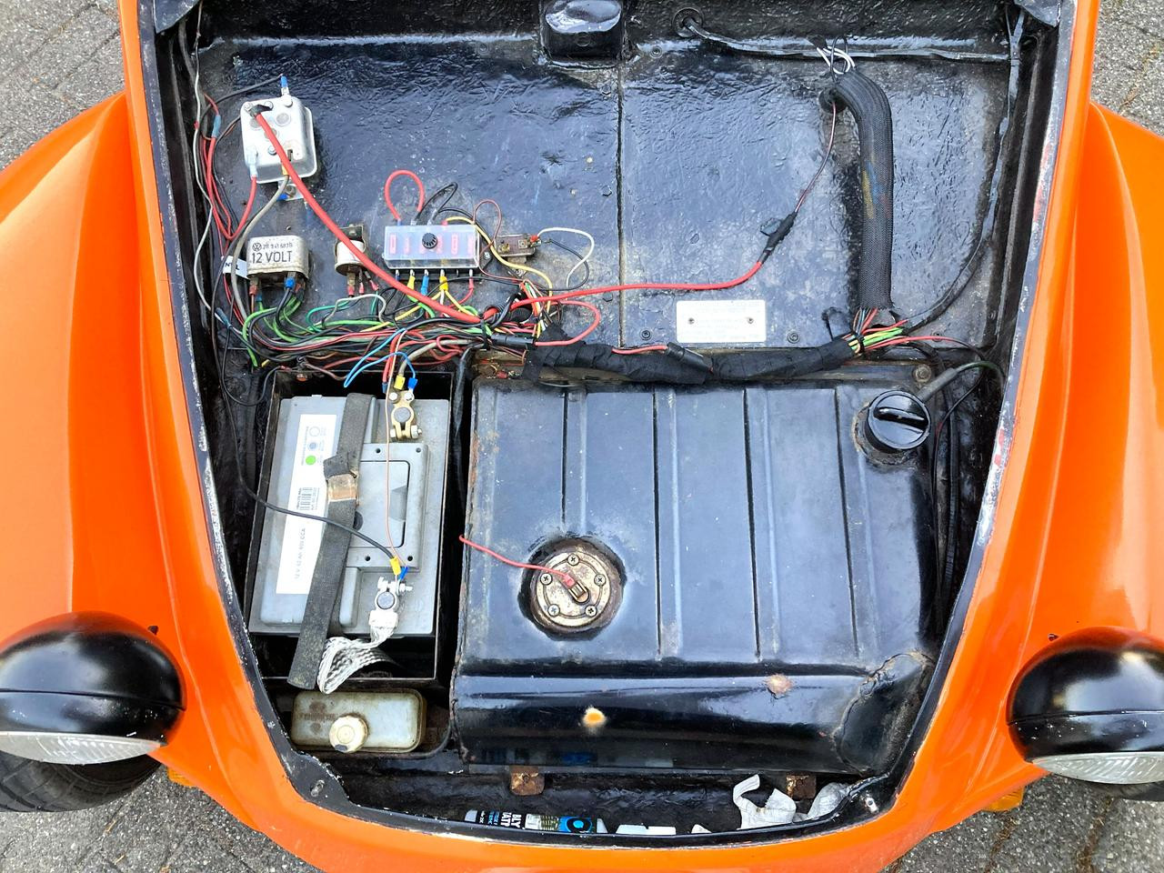

Electrickery
One thing I did not want was old fashioned 1966 electrics. I wanted a state of the art keyless ignition system, full digital dash and electrics from the 21st century.
So I simply designed and drew out an entire vehicle electrical system on a bit of paper and then built it.
The petrol pipe filler that you can see from the corner of the tank was going to prove to be a major problem later on.

Take for instance my initial trip to the MOT station in 2006 - I had spent many weeks pouring petrol into the Buggy and moving it around the yard, and had not envisaged that when I pulled up at a petrol station that the pump nozzle would not fit the right angled filler neck and would take 10 minutes to fill.
Remedy: Remove the bonnet, cut and weld a new flange onto the fuel tank (yes, I did say weld a fuel tank) then find that the inside of the tank is rusty, buy a new tank and relocate the fuel filler to the centre of the bonnet.

Fusebox
Because I have uprated the electrics, and didn`t want to use the "Continental" style fuses, I opted for a modular fusebox. Each "module" consists of a relay socket and three fuses beneath it, and these can simply be clipped together to form a long bank as can be seen here.

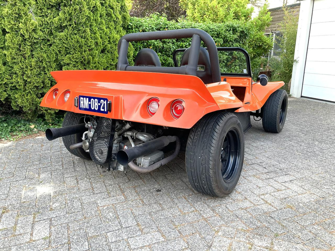

  • Posts: 9152
Reply #14 on: March 25, 2013, 11:04:48 AM
I had a rear cage built for me by Powercraft in Torquay - I wanted something that was a little closer to the engine than some of the "off the shelf" cages were, and I an very pleased with the results.
The top rails attatch to a flat plate that is also attatched to my roll cage, and the bottom mounts are attatched to the frame horns in the usual way.
