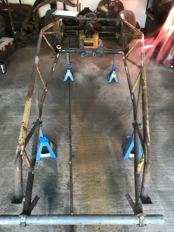

So ... I toyed with the idea of this purchase for some time and finally did it . I didnít kid myself as to what I was buying , which is believed to be an early 80ís UVA sandrail .... and a bastardised one at that with obligatory 50mm scaffold tube welding in by a blind man using a stick welder . More rust and damage to the sub frame that the titanic currently has .

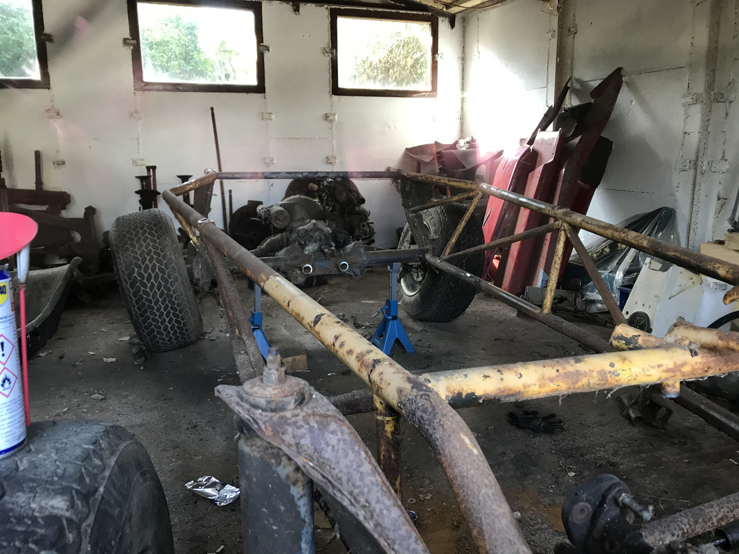

A true barn find . It was brought home to my modest concrete crap store . Which work started immediately with the use of a 9Ē grinder . All of the barbaric additions removed and I can see what I had .
But to be fair I still had the rust and rot of the frame to cut out as the Ali floor pan had been riveted to the frame and caused bad galvanic reaction .
I then spent the next hour removing the front beam , engine and gear box etc .
So finally at this stage , not a pretty one , but it needed it . Spent a few hours grinding back welds from old sections , welds of dog 💩 and hideous random brackets made from whatever fell off of lorries as they passed .

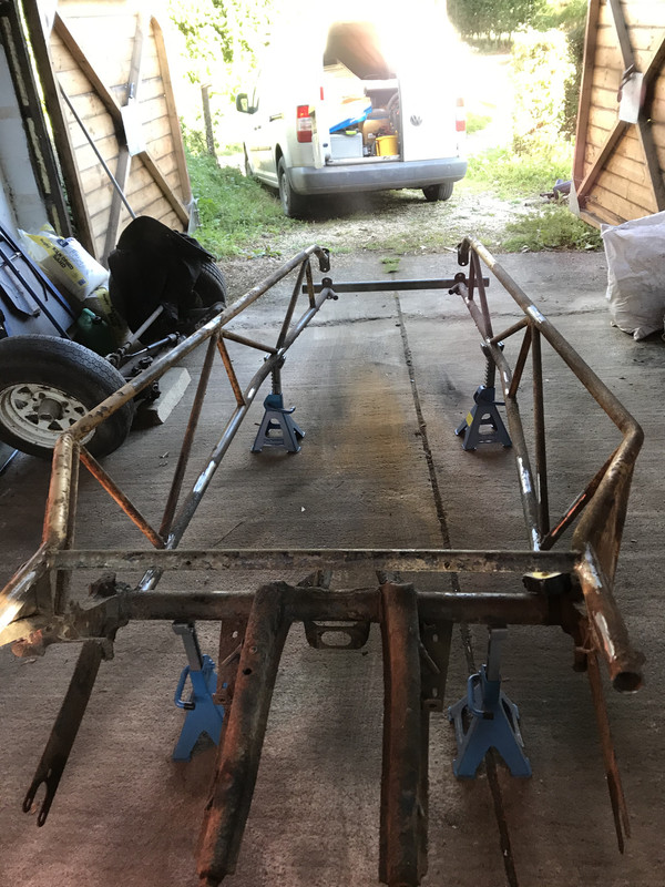

Ok , so I donít have a lot left , but what I do have is solid and ready to go forwards . A good sweep up and it looks good to go .
In the next week itís off to the shot blasters for a quick blowing over pre work to see whatís what . I am going to have to open a small section on each main 40mm tube as I have a lot of rivets to punch through and donít want them rattling around inside the tubes . Followed by welding them up and then some reinforcement of the lower two rails .
Already have three lengths of CDS en route , two 42.5 and one 26mm to start working back in . Just ordered a hole saw notcher, just need to rig up a bench to work at .

You are a brave man taking that on, aluminium touching steel is never good long term in a frame as it causes galvanic reaction.
wet blasting engine cases is not a good idea as media can get into the oil ways and ruin a new build and acid clean or a good degreaser followed by a purge of all oil galleries.
