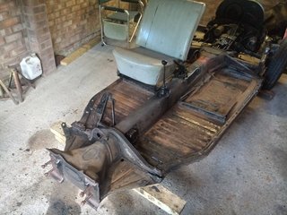

Thanks everyone. Photo of current stage, lots of cleaning up! Managed to take off the front beam without snapping anything. 3 days of soaking in WD40.

Looking at the picture the pans they seem to be fairly decent. Are they the original ones. If so it may well be worth considering localised repairs. Possibly take the seam sealer off and cleaning and repainting then reapplying the seam sealer.
