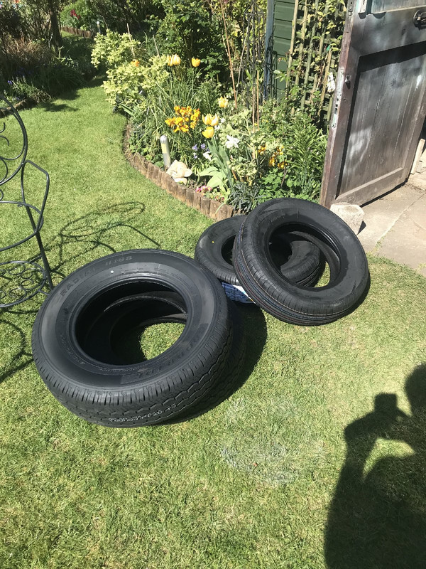

Reply #32 on: April 14, 2020, 03:20:57 PM
it has been quiet with the covid restrictions but these arrived today.
195/70 X 14 fronts and 215/70 X 15 rears so as everything is closed into the shed and bead breaker out
got first one on a change from the 275/60 X 15 that were on the 7Ē rims but needed a squirt of brake cleaner and a flame to initially get the beads to seal.
the fronts went on easily and are soft walled so should be good on the biggy but up from 185/60 X14
they can get balanced at the mot station later on.

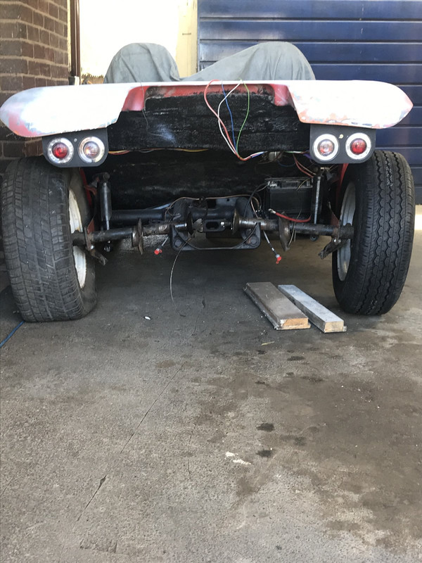

  • Posts: 8441
Reply #43 on: May 17, 2020, 06:09:15 PM
Today was a simple plug the 1303 wipers to the Column switch after removing my loom Connect the earth and put a live in.  Mmmm wipers no work and blows a fuse so reset able fuse in Have a look at the motor speed 2 fine speed 1 works as a constant with the ignition no fuse blow, looks like time to strip the switch out as that is unknown. So fitted the motor instead just needs the fuel tank modifying and hoses. Pedals out to fit a new cable as doing it through the chassis hole is impossible with big finger. Got it outside for a photo or 3
Engine fit shows the Rearbody is 1/4 to the left with the twist in it And putting it back down the 1Ē has caused it to foul the fan shroud.
