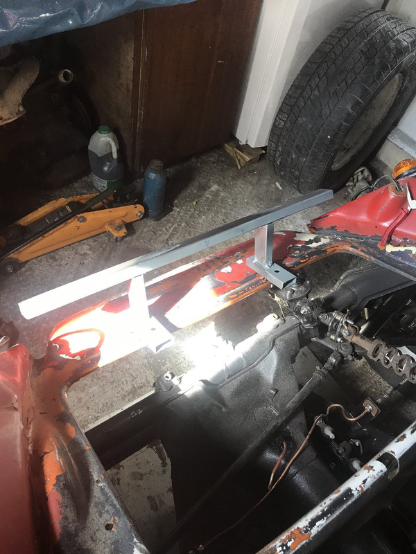

Stuck for the gearbox so it will not roll out of the garage. Brake pipe tool from Ed’s autos meant I could get the pipes done and get the body bolted down. After a few hours making the side pods tall enough to touch the body along their length.
Front body supports done but cannot get the welder in now.
Pleased the new bonnet fits nicely just needs a few mm’s trimmed of in 2 places

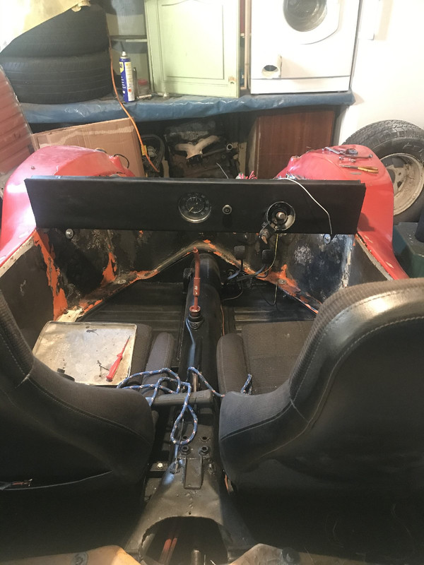

Reply #22 on: March 26, 2020, 05:24:11 PM
today was manufacture a dash frame it took longer than expected, dash is ready for covering in leather cloth in the morning when the mounting screw adhesive has set.

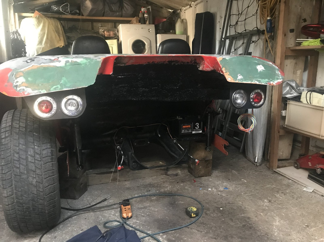

not sure wether to paint or polish the rear light mtgs thinking matt black will be better

Reply #23 on: March 26, 2020, 05:37:49 PM
Matt black is a smart and safe colour which will resonate with the seat colour unless you intend parking near Vanessa and want something shiny to impress her !

Matt black it is Hugh but VHT exhaust coating as the matt black tin ran out, reshaped to lower the lights and recut the bottom corners, now it shows the l/h body deeper than the right so will need trimming once on all 4 wheels.
dash covered and column in just need a w/s washer switch when we get back to normal.
a quick pic of the front body support after painting.
