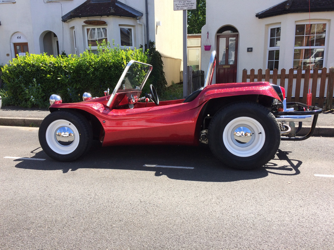

Last week I changed the wheels and tyres on mu buggy as I wanted a more traditional look, getting away from the nose down, arse up look the buggy used to have.
Before:
After:
The problem is lack of clearance with the taller profile front tyres.    I've gone from 195/50x15 (22.7 inch tall)  to 205/60x15 (24.7 inch tall).
The adjustable beam is supposedly set at it's highest setting.   The torsion arms are about horizontal - parallel to the ground.   Been a long time since I've had a beetle - on a stock height beam don't the torsion arms point downwards more?, ie. the beam end of the torsion arm is higher than the hub end.
I need to find more height without cutting the front wings back if I can help it, don't want to hack into the body!   Any suggestions?
