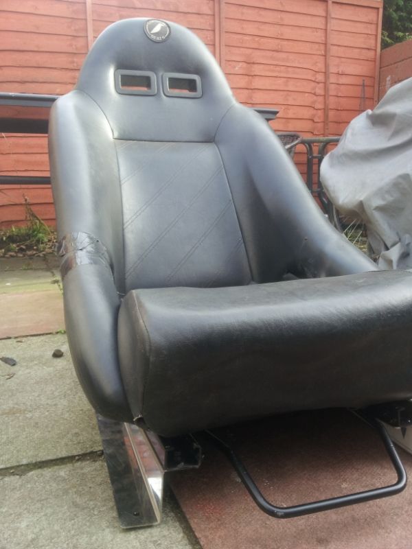

I got some stainless steel seat sub mounts and double locking seat slides off flatlands engineering today, so I'm going to see if I can fit my old seats to them for just now before I can get new ones. They are in real need of re-trimming but I think it might be cheaper just to get newer ones instead.

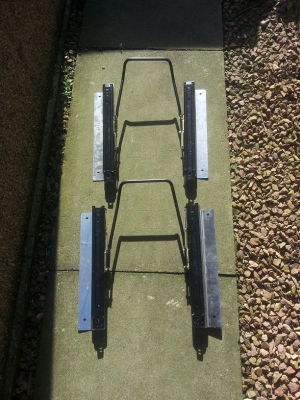

So with my first day off I've had in a while that I've not spent with the Mrs I made an active effort to get on with the bug.
I got some stainless steel seat wedges from flatland engineering and some seat runners too.
All bolted up.. Yum Yum

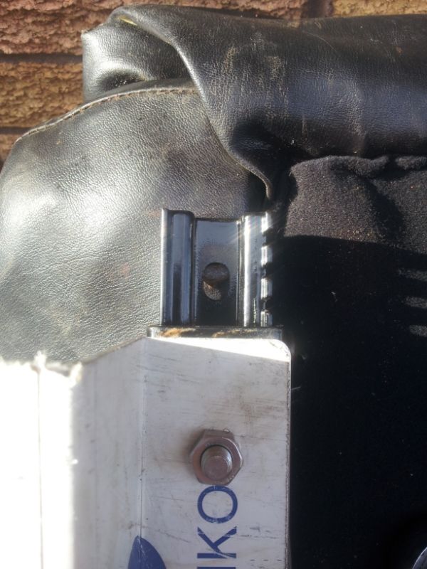

Aww shi... The holes are just a tad too short!  :-[
A little grinding work and TaDa!
Just gotta measure up the floor pan to drill now! and get new corbeau seats, but I cant afford them at the mo...

looking into it. id like to keep them for keeping the bugs history.

the stainless wedges were pre drilled from flatlands to the seat runners they sell. they bolt together well with m8 bolts.
my seats however were a tad too 'long' between bolt holes so i had to grind the last oval slot in the runners a few mm more to fit.

Ok so finally got my drivers seat 100% fitted into the car.
Took the plunge to drill some new 12mm holes in and I've used these plates under the floor so if it does go all horribly wrong at least the bolts wont pull through the floor and leave me in a right mess.
http://www.ebay.co.uk/itm/181045684531?ssPageName=STRK:MEWNX:IT&_trksid=p3984.m1497.l2649
I also go the seat sliders to work really well. I set them so that I can move the seat forwards up to 10'inches from its maximum backwards position. With the seat forward gives me a place to hide some goodies then move the seat back so they're hidden.
