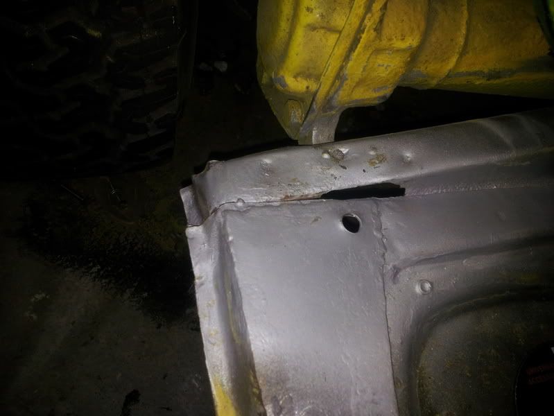

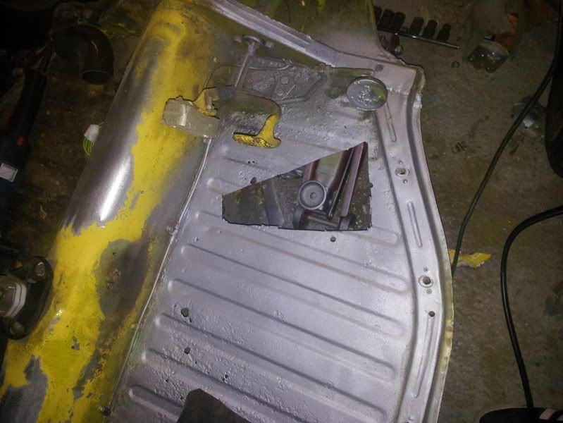

Heres a few pics of the restoration.... Still in progress!
Fred Flinstone inspired Rust removal...
Final mock up of the rear rusty bits and the plate I've made to weld into it and fix it up..

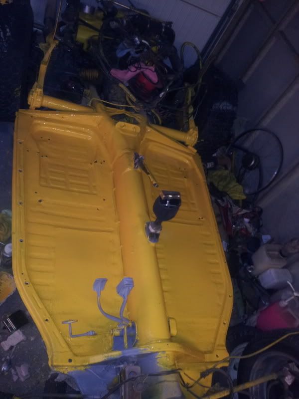

painted my first coat of hammerite yellow to the floor pans! woohoo progress!!

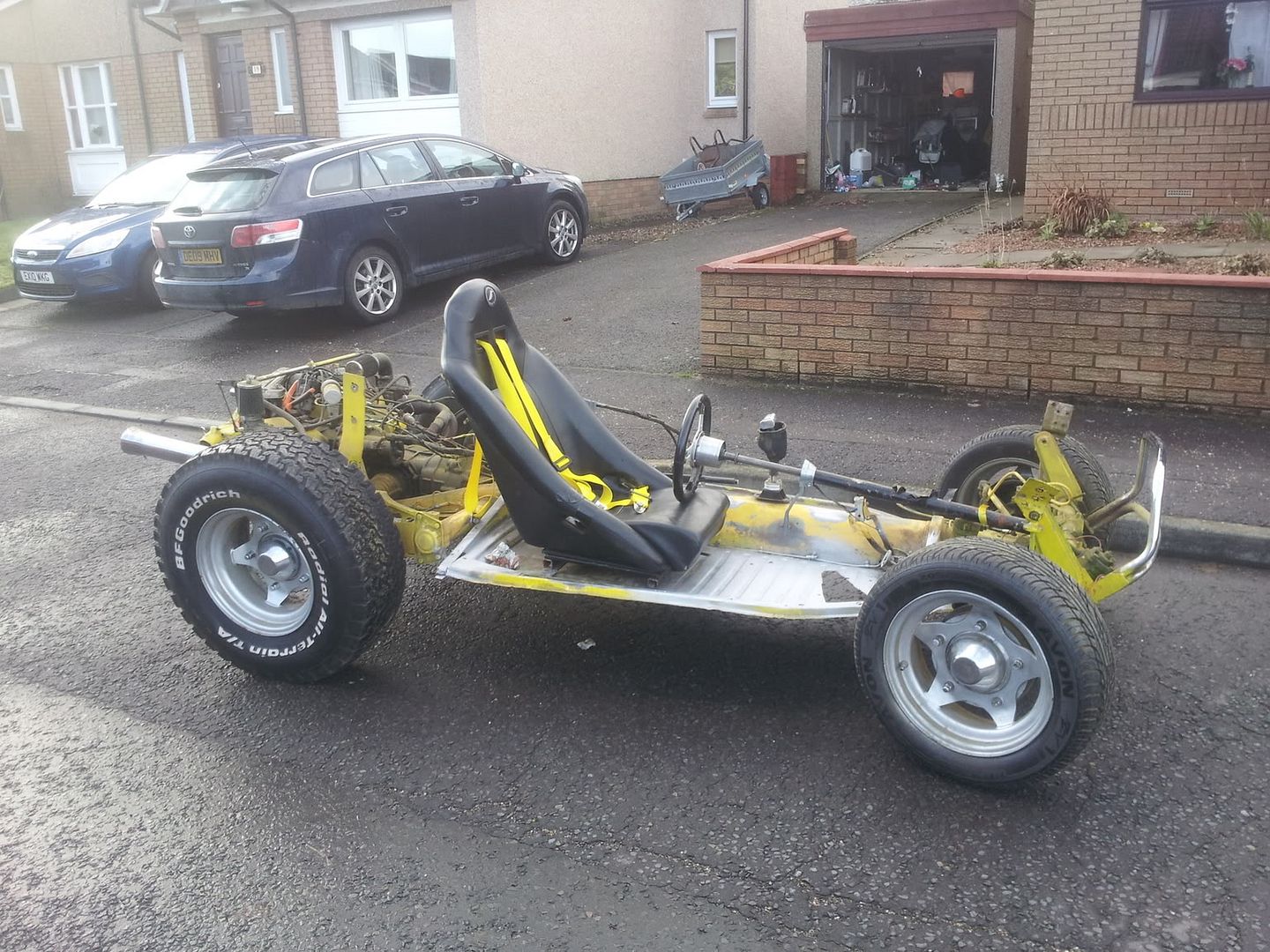

Reply #1 on: March 04, 2013, 02:14:11 PM
Well thats all the painting finsihed as far as the chassis and metal work is concerened. The floor pans and everything else I could make hammerite yellow are now, uhh, yellow!
The cibie's will be left until I get the shell done as I want them the same colour.
After a fair bit of swearing and threatening the exhausts with the angle grinder I got them off and gave them a quick going over with the wire wheel to get ride of the rust. They're pretty badly pitted but no major holes. Just a few tiny pin head ones I can seal up.
Just need to convince the old boy to help trailer off the shell somewhere to get painted then stick it all back together again....  :o

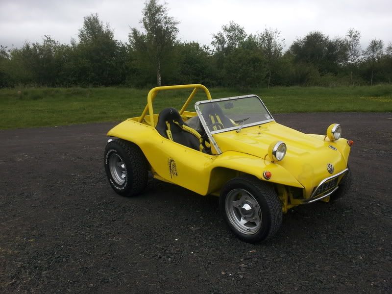

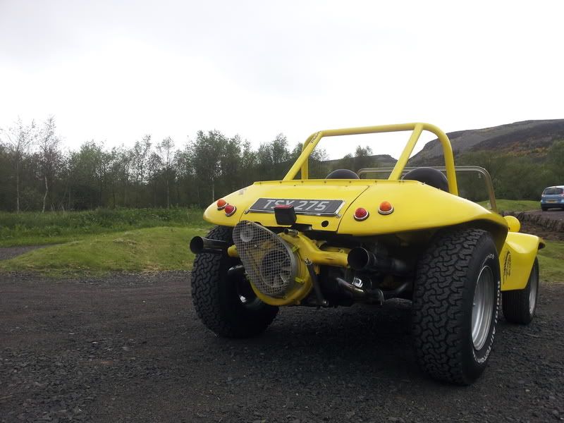

Reply #14 on: April 14, 2013, 09:40:52 PM
Had a look under and I couldn't see any noticeable marks but that could just be down to whoever did it make a good job haha!
Anyway did a little bit of work between shifts at work. Ordered a whole load of stainless bolts screws etc etc. Replacing everything I can with stainless so I'll hopefully never have to deal with rust again!!
New rear lights and stainless steel reg plate holder, the one I had before was terrible plastic  bleugh. Also re-done the headlights to match the new yellow/black theme I've got going on...
